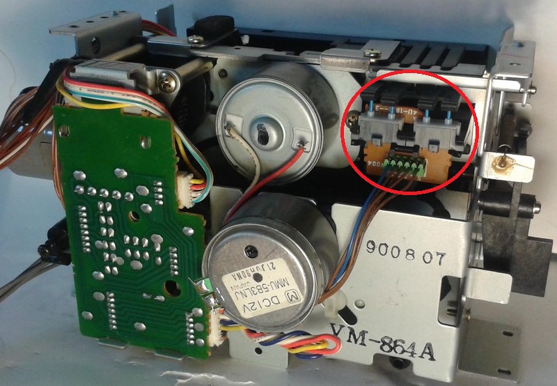

Thank you Bob for this very detailed post regarding the way the DENON DRM-800A cassette deck is operating.
However, I don’t see any explanation for my whimsical tape selector issue.
I noted that a CrO2 cassette can very well be recognized as type I at the beginning of playback, then as type II during playback, to return to type I at the end of playback.
As you know it well, it is the contactors circled in red in the pic below that determine the type of tape.
[Bild: Tape-Selector-Issue-Denon-DRM800-A.jpg]
Would these contactors be defective? How to check it?
Bob is absent since a long time. So maybe anyone will help you…
You should try to clean the contacts (e.g. piece of paper with IPA). Please refer to the service manual to see how you can remove (or loose) the contacts if necessary.
I'm not familiar with the deck and therefore I can't give specific instructions. Sorry.
Calimero
(27.08.2025, 12:19)Calimero schrieb: You should try to clean the contacts (e.g. piece of paper with IPA). Please refer to the service manual to see how you can remove (or loose) the contacts if necessary.
Calimero
I tried to clean the contactors as recommended without success.
The solution is therefore to be sought on the side of electronics.
Not having any knowledge in this field, I thought I would find someone who might have had leads to suggest to me.
Note: Playback and recording are not disturbed by this malfunction.
