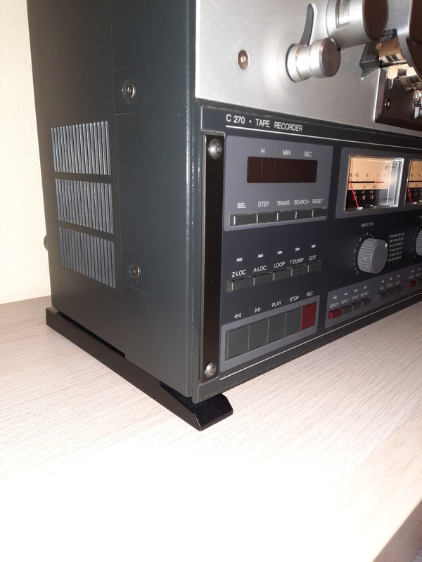

Hello,
I took some measurements but I did not remove the machine from the rack, so you have to take the positions for the screw holes from you machine.
Length: 205 mm
Width: 27 mm
Height at screw positions: 20 mm
The front of the feet exceeds the front of the machine for 10mm
And here is a picture:
[Bild: 8-C6-E88-B4-D11-C-4-F39-B881-3401-A70-ECCFD.jpg]
Good luck!

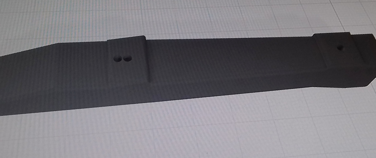

Hi Harold
Here you can see the result of 3D-Print :
[Bild: 20221223-184437.jpg]
[Bild: 20221223-184501.jpg]
Greetings from Germany

Hallo Hans-Volker
Die vorgaben für einen 3D-Druck habe ich noch :
[Bild: 20240703-144537.jpg]
[Bild: 20240703-144553.jpg]
