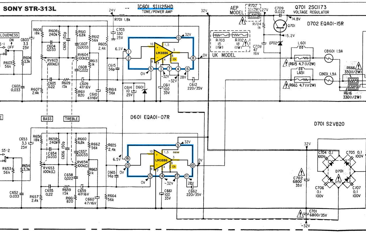

Hi EOA,
I have a similar issue with my SONY 313L receiver, broken Sanken SI 1225HD IC.  I already purchase two LM3886 and since I am beginner in electronics and I dont have clue what pin goes where, so I would be very thankful if you can provide me some schematic or picture of board where LM3886 is placed and wire connections.
I already take out old SI 1225HD and place new two LM3886 on heat sink.
As I can understand I need to add 2 more 47mF capacitors?
Should I take out old capacitors (C661,C662,C611,C612) and bridge them?
thanks and best regards
Zoran
#33
[Bild: Sony-STR-131-L-schematic-detail-power-amp.png]
Hi Zoran,
this is how I would do it. Don't care too much about the extra caps I recommended in the original TA-313 solution. These were just additional bypass for the positive rail.
As far a I can remember, the two LM3886 need to be of the isolated F type (plastic back) or otherwise need a silicon pad for isolation when mounted. Check in the old posts in this thread.
Pin 9 of the original SI1125HD pinout is in common for both channels, as positive rail.
Hope this helps. Let us know how it worked out.
regards
Johannes

Dear Johannes,
You really take some time and effort to make complete schematic!
I am very grateful to you, thank you very much, I will let you know how it work out.
Best regards
Zoran
#35
Hi Johannes,
I did it with your schematic, amplifier works beautifully, but tuner is working only in mono mode and very quietly but this is another issue, I have schematic and gonna search for problem, and by the way improve my electronic skills. Working on vintage electonic seems to be simple.
Thank you very much,
Best regards
Zoran

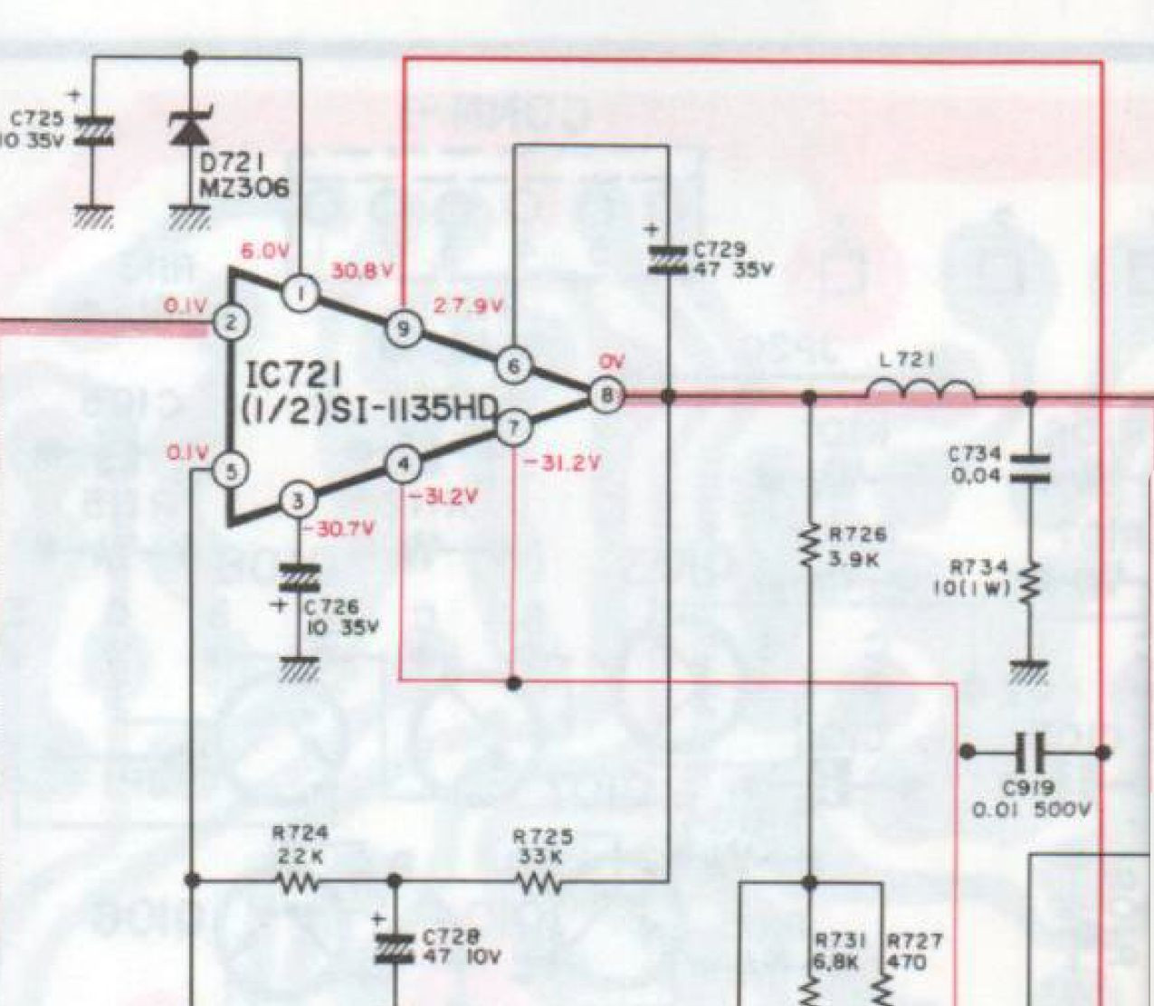

Hello,
I am writing from the U.S. and apologize for not speaking German.
The Mitsubishi X-10 I'm working on has a bad SI-1135HD, and I plan to replace it with two LM3886. It appears that there isn't anything different from the Sony STR-313L modification, correct?
[Bild: SI-1135HD-Mitsubishi.jpg]
